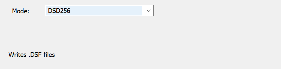

Compression Options
Mode sets the DSD sample rate, DSD256 and DSD512 create very large files.
