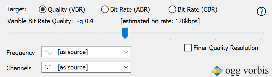

Ogg Vorbis offers 3 types of encoding:
Frequency number of samples per second to be encoded, [as source] allows the output frequency to be set the same as the input frequency (recommended).
Channels:
Finer Quality Resolution simply allows a finer selection of the quality value.
- Quality Target Variable Bit Rate (VBR) VBR files are made up from 100's of small audio chunks, called frames. Whilst encoding VBR, the encoder decides which bit rate to use for each frame. Bit rates can drop down to lower values when it is warranted (if there is not much sound complexity) and switch up to a higher bit rate when required. VBR files should be used when encoding unless there is a specific reason not to
- Average Bit Rate (ABR) a little like VBR except constraints are placed on Bit Rate so that over time it averages out to the desired value
- Constant Bit Rate (CBR) a constant bit rate is used throughout the encoding process
Channels:
Stereo two channels of sound, enables instruments to appear separated from one another
Mono a recording with only a single channel of information
[as source] sets the channels to match the input channels (recommended)
