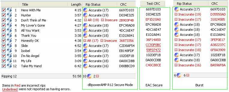

Program Tracks Ripped without Error  Ripped with Errors
dBpoweramp 64 16
Exact Audio Copy 53 27

dBpoweramp R12: Secure Mode: Pass 1 AccurateRip Verified, Pass 2: Maximum Drive Ripping Speed, Ultra Secure Mode (min 6, max 10 finish after 2 clear passes), Pass 3: Maximum re-reads 48, Drive Speed Maximum. If C2 was enabled then Ultra Secure was set to 1 minimum pass to verify the C2 result (maximum re-reads was 700).
All drives tested support Accurate Stream.
 The Results
We will let the results speak for themselves, tracks without errors are best, next are tracks with errors (and errors reported), finally if a rip had errors but was not reported as such that is the worst a ripper can do.

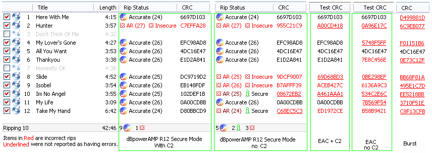

Plextor - PX708a
Program Tracks without Errors  with Errors (errors reported) with Errors (errors not reported)
dBpoweramp with c2 10 2 0
EAC with c2 10 2 0
dBpoweramp no c2 10 2 0
EAC no c2 9 2 1

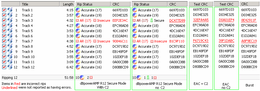

Matshita - UJDA757
dBpoweramp 10 2 0
EAC 7 3 2
NEC - DVD-RW ND-2510A
dBpoweramp with c2 9 1 0
EAC with c2 5 2 3
dBpoweramp no c2 5 3 2
EAC no c2 2 3 5

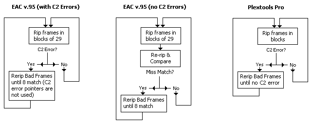

New Ideas
Firstly we thought it was important to move away from the [read block][re-read block] & compare method, this method jiggles the CD drive backward and forward head many times a second causing stress to the drive (in Illustrates opinion). A new strategy is to rip in complete passes (AccurateRip is able to jump in and stop a rip after any pass it if agrees with AccurateRip). In addition Ultra Secure passes can be used to detect those hard to detect errors. These diagrams show different ripping methods:
Plextools Pro relies 100% on C2 error pointers reporting the errors, whilst on a drive with a good C2 error pointer implementation a very high % of errors are detected, a small percentage do slip through undetected.
EAC with C2 error detection on uses C2 pointers to detect errors, when an error is found C2 error pointers are not used, that is why on the above tests (with C2) EAC reported no errors on certain tests where C2 error pointers could have prevented that. Without C2 error pointers EAC rips, then re-rips and compares - should an error be duplicated in both reads it will pass through undetected.
dBpoweramp's method is quite a bit different to the traditional Ripping methods, using a concept of complete passes to identify errors and put less physical stress on the drive. With C2 error pointers an optional ultra pass can be used to identify errors which slip through the C2 net (no matter how well C2 is supported on a drive). The re-rip code on identified bad frames is pretty standard except we also implemented routines to try to detect interpolation many drives do when there is an error.
With no C2, there are always 2 passes after which a cross-check is done against AccurateRip to determine if elements in each of the pass were correct. Ultra passes are useful in detecting errors when C2 error pointers are not supported, the Matshita drive especially needed the extra passes to detect errors (sometimes detecting new errors 6 passes in).

Plextor - PX708a
This drive caches, the cache can be cleared in EAC with -usefua, and through the FUA option in dBpoweramp. This Plextor was quite impressive at ripping the results are very good.
dBpoweramp R12 & C2
Track 1: Ripped in 0:16 Pass 1 AccurateRip: Accurate (confidence 17)
Track 2: Ripped in 0:16 Pass 1, Re-Rip 1 Frames AccurateRip: Accurate (confidence 19)
Track 3: Ripped in 5:59 Pass 1, Re-Rip 262 Frames AccurateRip: Inaccurate (confidence 17) Insecure
Track 4: Ripped in 0:13 Pass 1 AccurateRip: Accurate (confidence 18)
Track 5: Ripped in 0:10 Pass 1 AccurateRip: Accurate (confidence 18)
Track 6: Ripped in 0:09 Pass 1 AccurateRip: Accurate (confidence 18)
Track 7: Ripped in 2:32 Pass 1, Re-Rip 104 Frames AccurateRip: Inaccurate (confidence 17) Insecure
Track 8: Ripped in 0:11 Pass 1 AccurateRip: Accurate (confidence 17)
Track 9: Ripped in 0:09 Pass 1 AccurateRip: Accurate (confidence 18)
Track 10: Ripped in 0:08 Pass 1 AccurateRip: Accurate (confidence 17)
Track 11: Ripped in 0:06 Pass 1 AccurateRip: Accurate (confidence 18)
Track 12: Ripped in 0:14 Pass 1 AccurateRip: Accurate (confidence 16)

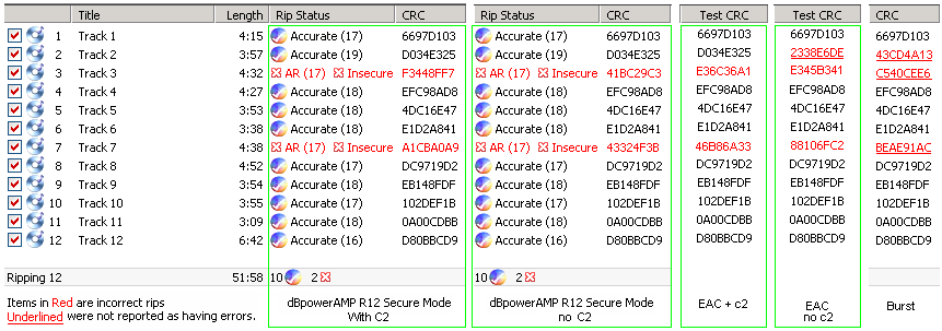

Plextor - PX230a
Out of all the drives tested this Plextor ripped the best, not much work was required by EAC or dBpoweramp.
dBpoweramp R12 & C2
Track 1: Ripped in 0:10 Pass 1 AccurateRip: Accurate (confidence 17)
Track 2: Ripped in 0:09 Pass 1 AccurateRip: Accurate (confidence 19)
Track 3: Ripped in 1:51 Pass 1, Ultra 1 to 1, Re-Rip 289 Frames AccurateRip: Inaccurate (confidence 17) Insecure
Track 4: Ripped in 0:08 Pass 1 AccurateRip: Accurate (confidence 18)
Track 5: Ripped in 0:07 Pass 1 AccurateRip: Accurate (confidence 18)
Track 6: Ripped in 0:06 Pass 1 AccurateRip: Accurate (confidence 18)
Track 7: Ripped in 1:50 Pass 1, Ultra 1 to 2, Re-Rip 91 Frames AccurateRip: Inaccurate (confidence 17) Insecure
Track 8: Ripped in 0:07 Pass 1 AccurateRip: Accurate (confidence 17)
Track 9: Ripped in 0:05 Pass 1 AccurateRip: Accurate (confidence 18)
Track 10: Ripped in 0:05 Pass 1 AccurateRip: Accurate (confidence 17)
Track 11: Ripped in 0:04 Pass 1 AccurateRip: Accurate (confidence 18)
Track 12: Ripped in 0:09 Pass 1 AccurateRip: Accurate (confidence 16)

NEC - 2510A
This drive supports C2 and does not cache. Track 3 + 7 could not be ripped (10,000 bad frames per track), so will be excluded.
dBpoweramp R12 & C2
Track 1: Ripped in 0:18   AccurateRip: Accurate (confidence 24) [Pass 1, Re-Rip 3 Frames]
Track 2: Ripped in 4:45   AccurateRip: Inaccurate (confidence 27) Insecure [Pass 1, Re-Rip 90 Frames]
Track 4: Ripped in 0:15   AccurateRip: Accurate (confidence 26) [Pass 1, Re-Rip 1 Frames]
Track 5: Ripped in 0:11   AccurateRip: Accurate (confidence 26) [Pass 1]
Track 6: Ripped in 0:13   AccurateRip: Accurate (confidence 26) [Pass 1, Re-Rip 12 Frames]
Track 8: Ripped in 0:41     AccurateRip: Accurate (confidence 25) [Pass 1, Re-Rip 28 Frames]
Track 9: Ripped in 1:18     AccurateRip: Accurate (confidence 26) [Pass 1, Re-Rip 233 Frames]
Track 10: Ripped in 0:18   AccurateRip: Accurate (confidence 25) [Pass 1, Re-Rip 31 Frames]
Track 11: Ripped in 0:08   AccurateRip: Accurate (confidence 26) [Pass 1, Re-Rip 1 Frames]
Track 12: Ripped in 0:38   AccurateRip: Accurate (confidence 24) [Pass 1, Re-Rip 64 Frames]
dBpoweramp R12 & no C2
Track 1: 0:43   AccurateRip: Accurate (confidence 24) [Pass 1 & 2, Cross-Check Match ]
Track 2: 1:57   AccurateRip: Inaccurate (confidence 27) Insecure [Pass 1 & 2, Ultra 1 to 3, Re-Rip 157 Frames]
Track 4: 0:27   AccurateRip: Accurate (confidence 26) [Pass 1 & 2]
Track 5: 0:10   AccurateRip: Accurate (confidence 26) [Pass 1]
Track 6: 0:56   AccurateRip: Accurate (confidence 26) [Pass 1 & 2, Ultra 1 to 3, Re-Rip 31 Frames]
Track 8: 1:14   AccurateRip: Inaccurate (confidence 25) Insecure [Pass 1 & 2, Ultra 1 to 3, Re-Rip 54 Frames]
Track 9: 2:48   AccurateRip: Inaccurate (confidence 26) Insecure [Pass 1 & 2, Ultra 1 to 3, Re-Rip 559 Frames]
Track 10: 1:02 AccurateRip: Inaccurate (confidence 25) Secure (Warning) [Pass 1 & 2, Ultra 1 to 3, Re-Rip 94 Frames]
Track 11: 0:06 AccurateRip: Accurate (confidence 26) [Pass 1]
Track 12: 1:35 AccurateRip: Inaccurate (confidence 24) Secure (Warning) [Pass 1 & 2, Ultra 1 to 3, Re-Rip 61 Frames]
EAC & C2
Track 1: Ripped in 0:30 Quality 99.4% Accurately Ripped (confidence 24)
Track 2: Ripped in 1:20 Quality 96.7% ** Rip not accurate ** (confidence 27)
Track 4: Ripped in 0:16 Quality 100% Accurately Ripped (confidence 26)
Track 5: Ripped in 0:13 Quality 100% Accurately Ripped (confidence 26)
Track 6: Ripped in 0:17 Quality 99.3% Accurately Ripped (confidence 26)
Track 8: Ripped in 1:19 Quality 97.8% ** Rip not accurate ** (confidence 25)
Track 9: Ripped in 2:55 Quality 95.1% (read + sync err) ** Rip not accurate ** (confidence 26)
Track 10: Ripped in 0:56 Quality 97.7% ** Rip not accurate ** (confidence 25)
Track 11: Ripped in 0:08 Quality 100% Accurately Ripped (confidence 26)
Track 12: Ripped in 1:41 Quality 96.7% (read + sync err) ** Rip not accurate ** (confidence 24)
EAC & no C2
Track 1: Ripped in 2:14 Quality 99.3% Accurately Ripped (confidence 24)
Track 2: Ripped in 3:15 Quality 95.7% ** Rip not accurate ** (confidence 27)
Track 4: Ripped in 0:43 Quality 100% ** Rip not accurate ** (confidence 26)
Track 5: Ripped in 0:31 Quality 100% Accurately Ripped (confidence 26)
Track 6: Ripped in 0:53 Quality 99.1% (read + sync err) ** Rip not accurate ** (confidence 26)
Track 8: Ripped in 2:43 Quality 95.8% ** Rip not accurate ** (confidence 25)
Track 9: Ripped in 4:12 Quality 92.1% (read + sync err) ** Rip not accurate ** (confidence 26)
Track 10: Ripped in 2:31 Quality 95.3% ** Rip not accurate ** (confidence 25)
Track 11: Ripped in 0:32 Quality 100% ** Rip not accurate ** (confidence 26)
Track 12: Ripped in 3:34 Quality 93.7% (read + sync err) ** Rip not accurate ** (confidence 24)
