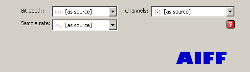

 These are the available options
when converting to AIFF:
        Bit depth sets the bit
depth of the output file(s). Bit depths are available from 8 to 32
bits. "[as source]" is the default setting and uses the bit depth of
the source file. Sample rate sets the
sample rate for the output file(s). Sample rates are available from 8
to 192kHz. "[as source]" is the default setting and uses the sample
rate of the source file.
		Channels
sets how many channels will be encoded in the output file(s). "[as
source]" is the default setting and uses the number of channels in the
source file (recommended).
